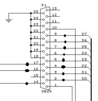

I got some feedback from a user that had problems with his programmer.
he added 5K1 pullup resistors to +5V. This is shown in the picture below. The dots (11) must each have a resistor of 5K1 to +5V.
